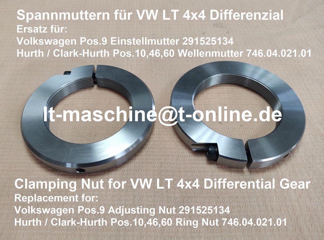

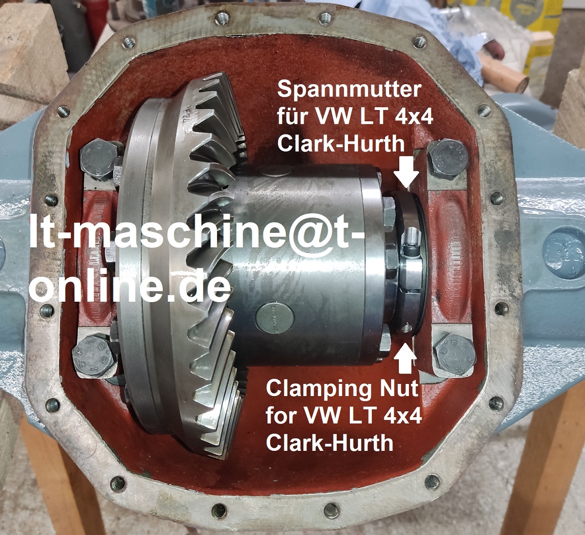

Hello LT-friends,
Due to the current situation, I would like to introduce you to my solution to the initial problem with the 4x4 Hurth axles.
I replace the inadequately secured adjusting nut with a "clamping nut"
Since 2020 I have been testing this with several 4x4 drivers in their vehicles and further developing it.
At this point, many thanks to everyone involved.
From now on I officially offer these clamping nuts.
The current price for 2024 is €150 net / piece (plus shipping and VAT)
From my point of view, the following advantages arise:
-The nut can no longer loose itself.
-It can be loosened, adjusted and fixed again as often as you like.
-The bearing play can be adjusted during an inspection.
-Due to the tension we no longer have thread looseness,
the nut sits firmly on the flange.
Annotation:
The design-related thread looseness of the original adjusting nut in connection with the rising and falling load
expands exponentially over the lifespan.
Which in some cases causes the flange and nut threads to deform/loosen,
although the caulking is still intact.
Then even a new nut won't help, as the mating thread of the flange is also damaged.
In this case, I offer an individual repair.
The thread of the flange is “re-cut” and a matching clamping nut is made.
The components can often be saved this way.
Best regards Carsten
Spannmutter als Ersatz für die originale Einstellmutter / Wellenmutter 291525134 bzw. 746.04.021.01
Fertig montiert in einer VW LT 4x4 Hurth Achse

Hello.
What is advantage of your assembly compared to the other assembly ?
Regards .
Bruno.
Re: rear or front Differential
BeitragVerfasst: Dienstag 19. März 2024, 20:42
von jokgel
Hallo Bruno , das ist ganz einfach zu erklären. Durch das spannen der Mutter , geht diese mit dem Gewinde eine Kraftschlüssige verbindung ein. Hat also keine Chance sich los zu spielen. Ich habe diese auch Verbaut und bin überzeugt das es eine super Lösung ist.
BeitragVerfasst: Mittwoch 20. März 2024, 16:18
von Pepitt03
Hello .
OK . I understand to not damage the screw thread .
Is it a fin or standard screw thread ?
Bruno.

BeitragVerfasst: Donnerstag 21. März 2024, 23:56
von Förster
Hallo und Moin Moin
Der Förster hat ebenfalls eine Klemmmutter von Carsten erhalten und ich bin nach wie vor sehr von der Lösung einer immer wieder verwendbaren Einstellmutter überzeugt,dies zeichnete sich besonders beim Einbau und der Einstellung ab.
Durch die Möglichkeit die Mutter immer wieder verwenden zu können und jetzt die Möglichkeit besteht quasi einfach mal eben so die Lager nachzustellen oder sogar im ausgebauten Zustand zu kontrollieren,ergeben sich für mich persönlich im Hinblick auf eine lange Nutzung unter anderem auch im Gelände deutlich bessere Möglichkeiten des selber Instandhaltens.
Alles in allem bin ich Carsten sehr dankbar für die Zeit die er sich mit mir genommen hat (und mit anderen natürlich auch).
Viele Grüße aus dem Norden
BeitragVerfasst: Freitag 22. März 2024, 18:20
von NF-LT 35
Auch ich habe diese Spannmutter" Made by Carsten" verbaut ,ich fahre sozusagen den Prototypen denn es war die erste, wobei Carsten diese auf mein defektes Diffi Gewinde angepasst hat,habe sie nun seid 36000km drin und was soll ich sagen --ES Hält :FREU: -- Ich kontrolliere es ca alle 10000km .Über die Vorteile dieser Variante brauche ich ja nix mehr sagen Siehe Förster Und Carsten.Ich würde Sie immer wieder ohne jeden Zweifel wieder verbauen.Vielen Dank nochmal an Carsten für die Unkomplizierte Hilfe
Gruß Jan

Hello .
Do you know the screw thread ? 60X 1,5 mm ? 75X1mm? or another .
I try to study by another way .
Bruno.
BeitragVerfasst: Freitag 29. März 2024, 11:21
von maschine
Hello Bruno,
if it were that easy...
I wouldn't have had to bother.
The thread does not correspond to any standardized thread that you could buy half-finished anywhere.
Of course, I've considered all of these things... and searched the entire Internet for possible semi-finished products.
Nevertheless, I wish you much success in your own experiments.
If you finally reach your goal at some point, you can add up what it cost you.
