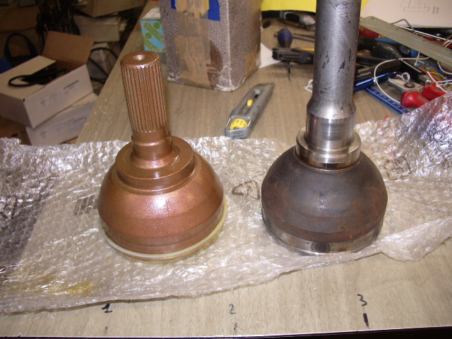

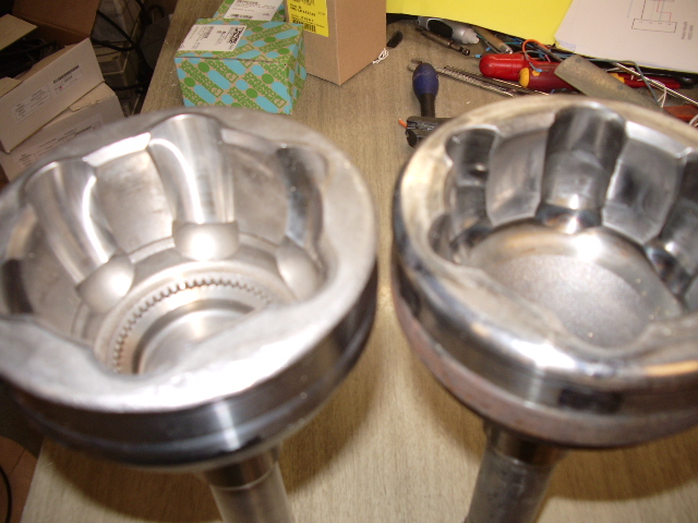

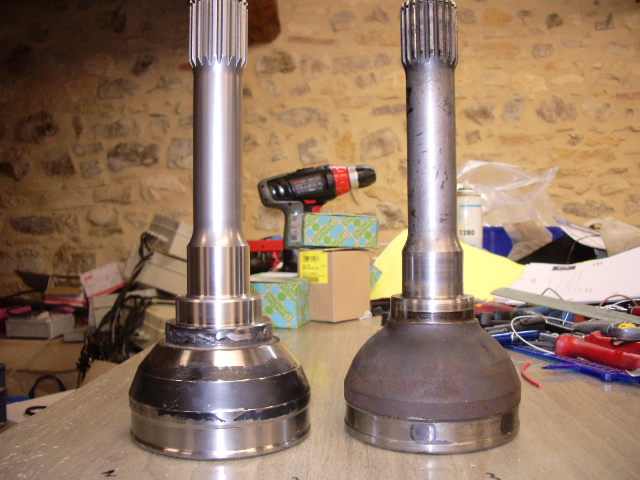

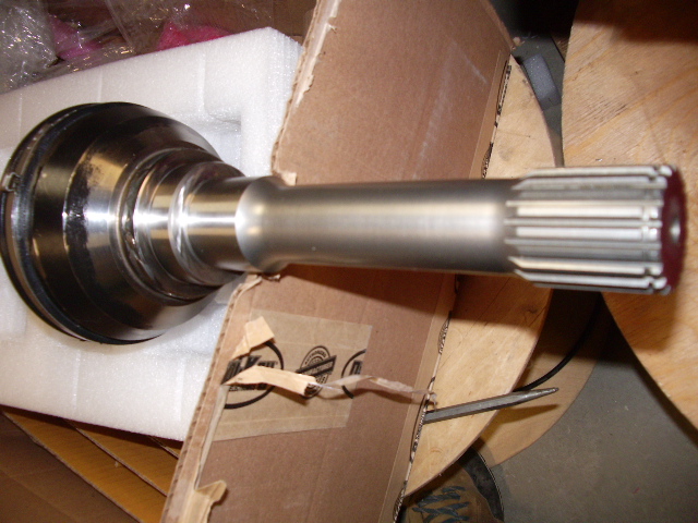

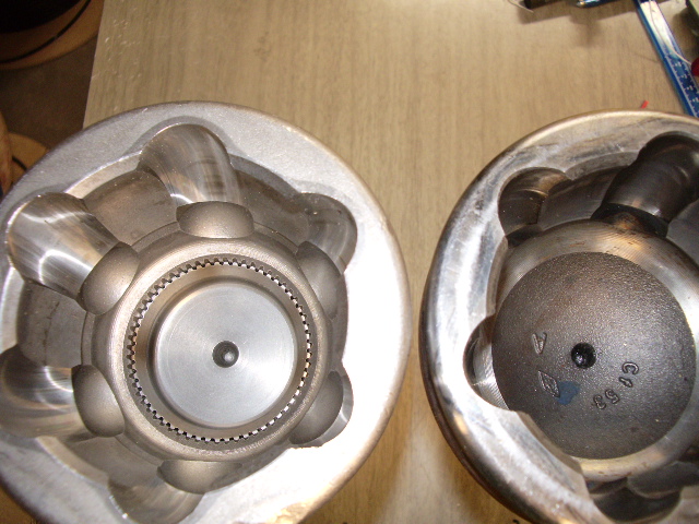

Beitragvon deepurple » Samstag 7. September 2019, 14:05
Hallo.
May be to find to remade CV JOINTS.
I know that CV joints from C35 Citroen or Fiat 142 are the same .
Cup is the same .
Balls are the sames
Nut is the same .
But shaft is different and short .
I had found a company . They remade gear boxes ,transfer boxes for race's cars and industry .
I ask , yes we can , we do it for race's cars .
I 'd bought CV C35 ;
Two months later , i had a CV LT 40 .
Some pictures to explain.
I drive on 2000kms this summer .
Bruno.
With axle
Inside
Inside
After remade outside
CV C35 near CV lt40 .
This is a lend / leihen .To see it's OK .
