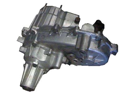

Sounds good, does it look like the TC on the enclosed Pic (bottom view, rear output down)?
See the long tail slip-yoke-housing!
Then, important, like mentioned in the Wiki - the spline count:
23 Input shaft (hollow)
27 rear output shaft
32 Front output shaft
and Mech Speedo drive.
Then again, you need the Rubicon Express kit 1801, and a self-made interflange!
Hope you have the capabilities - eg. access to a lathe or anybody who can make the modifications for you!
Good luck, Josef
NP242J old slip-yoke Version

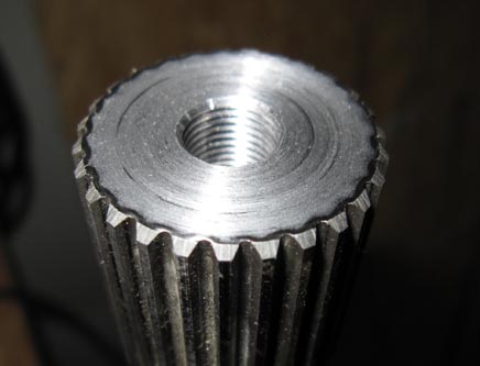

Even grinding down the shaft on a lathe should be possible without problems: the hardening is deeper than 0.1 mm.
See the pic of a shortened shaft; the hardening zone clearly can be seen.
Additionally, it is not obligatory necessary because the shaft/flange have no relative movement if mounted!
Greets Josef
Cutted and reshaped shaft
